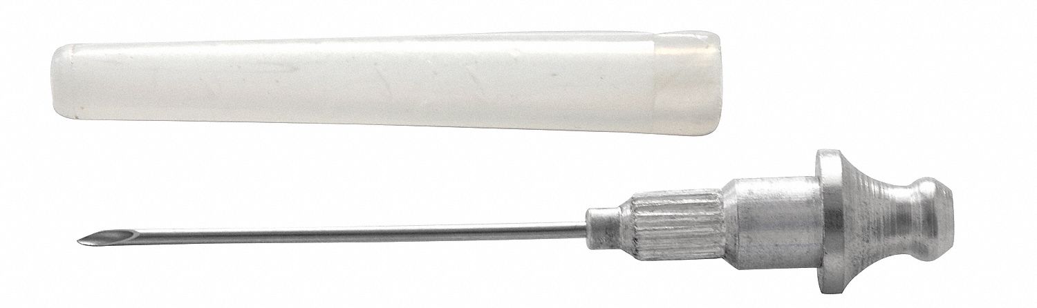

    I knew a guy who did this with snowmobile suspension wheel bearings. I bought a sled from him (old Indy 500) that had 21,000 miles on it. It had the original bearings in the suspension. He used a needle injector on his grease gun. The sled also had the original top end in it. I sold it 6-7 years ago and as of last year it was still running.
