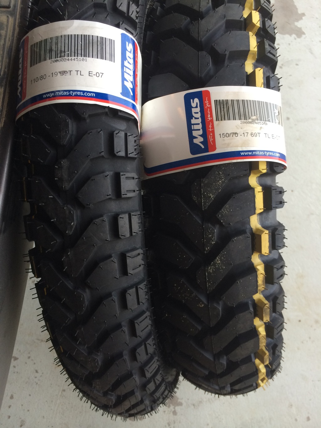

  17. hasenpfeffer Husqvarna
    CO
    Now I just need to get them on the bike. Should be a bit different than the Tourance EXPs.
    Riding Again and mario33 like this.

    I should be getting the same set the beginning of August. These are very similar to the Sahara 3's we have on our stock terra's just different sizes. Curious to see if there is a difference and what they wear like. Do the strada's have a 3.5" rim? I thought the 140 is almost too wide for the rim. Those are a 140/70-17 and the terras stock are 140/80-18 so might be close in size. Although looks like you are getting away with a bigger front tire. In the sand that would be huge.

  20. hasenpfeffer Husqvarna
    CO
    I have a strada. The front 110/80/19 matches stock. The rear stock is 140/80/17. The strada rear rim is 3.5". I've seen a few people using the 150 rear k60 and since I couldn't get the 140 e07, I decided to just go with the 150. 150s seem far more plentiful, so if it works out I'll probably stick with that size. Got them mounted and balanced, hopefully be riding on them tomorrow.
