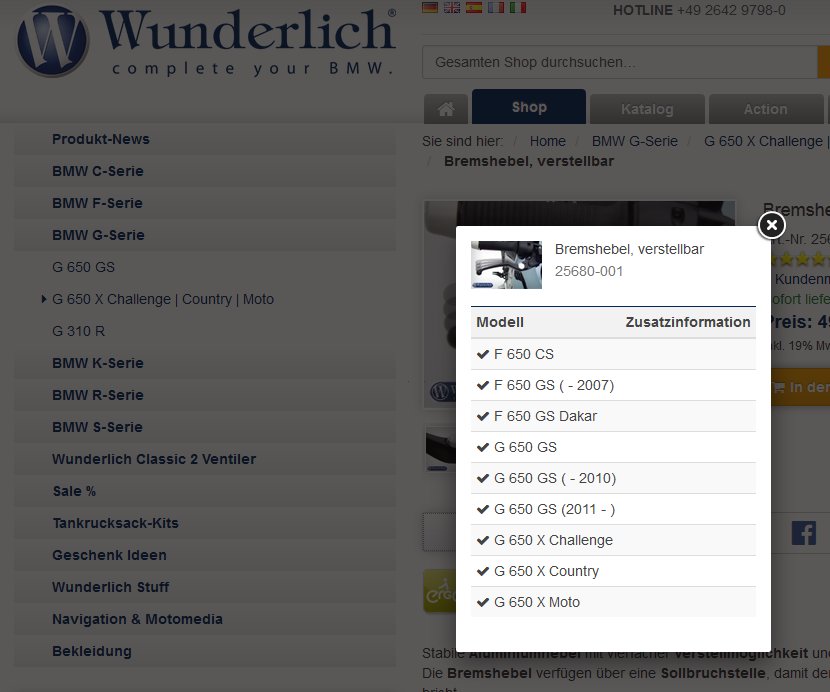

    As for something that IS compatible:
    Front brakelever is compatible with those BMW models:
    Clutchlever: choose aftermarket levers for the above models, shorts, longs, adjustable or not.
    Those proved a neat fit, even fitting with some clearance inside the Barkbuster loops. http://bit.ly/2cOiGlN
