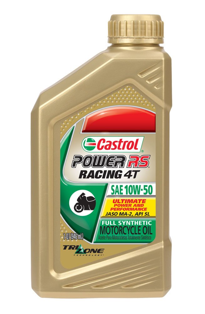

    I just purchased Castrol full synthetic 10W-50 FOR $7 us/ QT
    I did say I was done with oil in this thread so if anyone feels this type of oil
    is what they are looking for pm me and I'll send you the link.
    Castrol 06412 Power RS 10W-50 4-Stroke
    Big Timmy and Motosportz like this.
  2. Motosportz CH Sponsor
    I'm sure you can look up the contents and see the friction modifiers. There are several oil comparison charges floating around. I have yet to use an oil, any oil that made my clutch slip. I'm sure they are out there but lots of oils will not be an issue. IMHO.
