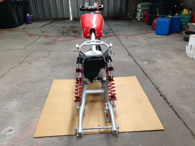

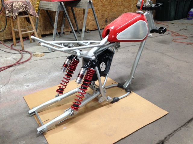

    http://i600.photobucket.com/albums/tt83/dartyppyt/Mobile Uploads/photo_zpsb0e03c32.jpg
    http://i600.photobucket.com/albums/tt83/dartyppyt/Mobile Uploads/photo_zps3affae5b.jpg
    Here are some shocks done so far.
    One pair I did on my own and 3 pairs I sent off to have Drew do @ WER Racing.
    By the time you order a kit, chase down what the kit doesn't include, get the oil and find a place to charge them, it is not worth it .
    Plus Drew can save you a buck here and there, like straighten a shaft, etc...
    I will tell you A + work!
    MOTORHEAD likes this.

  8. dartyppyt Husqvarna
    Illinois
    17 TE 150, 82CR 500
    82 125,250,430&500 79 390 83 250
    Thanx guys! It is a long slow task doing 6 at once but will be worth it in the end.
    I polished the reservoirs on the black and red piggys. I have a chrome and red Ohlin decal coming but they look good on the 82 CR 250. I will do the fork legs in red and black husqvarna lettering.

    You'll need sunglasses on, just to look at all the polish & paint LOL
  11. Motosportz CH Sponsor
    freaking awesome man.
  12. adam6402 Husqvarna
    Tulsa, OK
    None
    Really liking the polished cans with the red springs, It's gonna look killer!

    Lookin good Darin. I like the red set up on the shocks. Hmmmmmmmmmm..........

    Thanx guys!
    Even did some stuff on the 83 shocks but just didn't look right, so stayed with tradition.
    Chayzed, yes yours would good in those colors.
