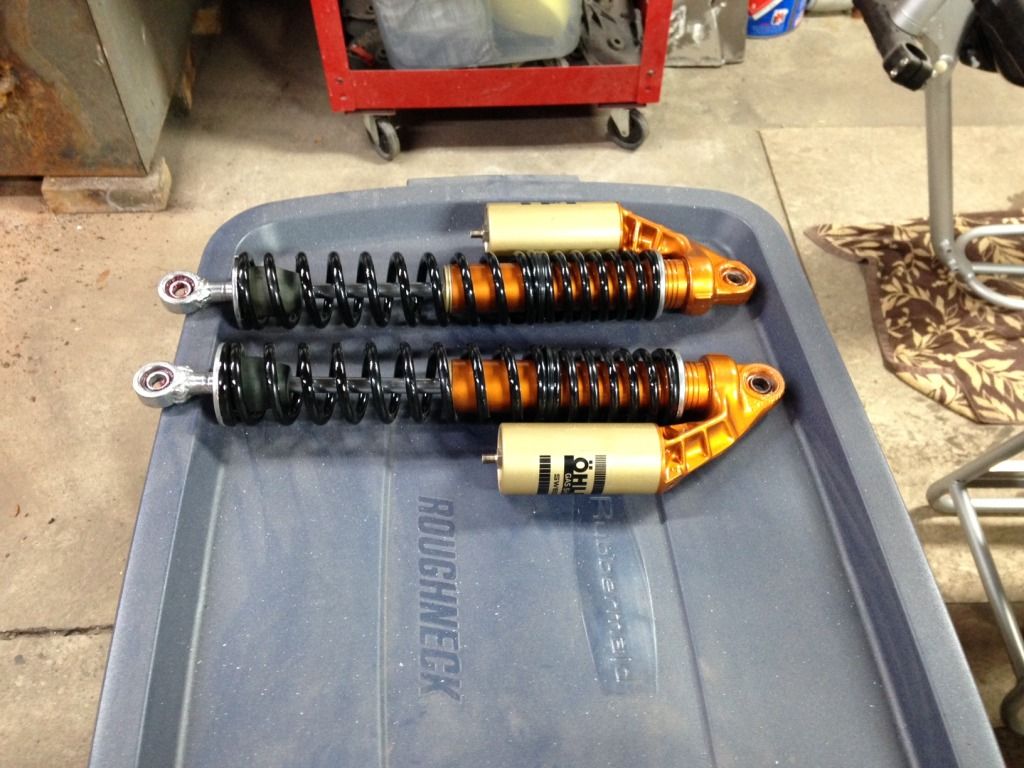

    Here is clutch cover for next one going together. 82 CR 250
    I enameled the husqvarna logo.
    This is for the fancy one with black shock bodies, red springs and polished reservoirs.

  2. dartyppyt Husqvarna
    Illinois
    17 TE 150, 82CR 500
    82 125,250,430&500 79 390 83 250
    Thanks. Ok, I have to get some of those arms. Totally forgot.
  3. justintendo klotz super techniplate junkie
    mercer, pa/northwest pa
    99 kawasaki zrx 1100
    you can use any liquid cooled lever to get the effect, i know the 87-88s had it factory. or phillip offers a new ss version..was going to suggest that as well, but wasnt sure how truly original you were wanting it to be. tis a nice upgrade. motor looks great! replating everything is a great touch
