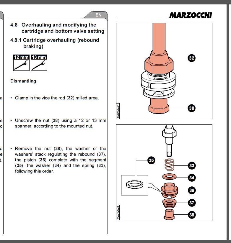

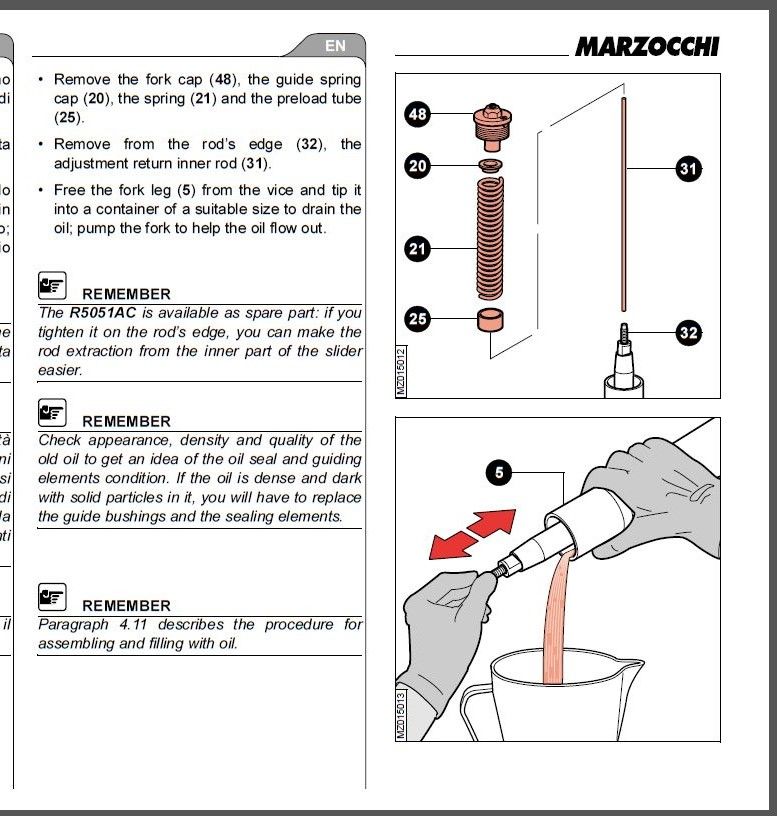

  7. DYNOBOB Husqvarna
    Thinking out loud here...
    Looks to me like #25 is the spacer. Based on how this appears to go together, I think 630 forks may be the same exact length as a 610, just less travel. This could be easily checked and it makes sense if the rear shocks are the same (bike still sits the same). For BMW, reducing travel increased road stability to "their" standards.
    I'd bet the 610/630 use the same springs also.
    But I've been wrong before :rolleyes:
  8. DYNOBOB Husqvarna
    I don't see anything else here that looks like it :excuseme:
  9. Fast1 Husqvarna
    Minneapolis, MN
    Bob,
    Thanks for posting the diagrams. I've been reviewing them prior to starting this thread and they have created the confusion for me.
    I'm sure item #25 is the preload spacer for the fork spring which would provide the fork static and race sag. Based on my research the spacer for reduced travel should be located on the dampener (pumping element rod #32). This would limit full extension of the dampener by 30 mm within the shock tube and create overall a lowered fork.
    I'm wondering if the fork overhaul pages you posted from the manual are actually for the TE610 full travel fork since the lowering spacer is no where to be found?? Maybe Husqvarna did not provide updated fork specs in the TE630 shop manual??
    My assumption is that if there is a 30mm spacer on the dampener that is limiting fork extension then removing it will allow another 30 mm of extension. To compensate, an additional 30 mm of spacer preload would have to be added to the existing preload spacer and spring (assuming the springs are identical in length). Make sense?
    By lowering the front forks, the geometry of the 630 would change providing improved road turning capability but sacrificing off road handling with more propensity to washout (knifing of the front tire) in soft or muddy conditions. This would also create some wobble in the front end at speed on the road unless you induce additional rear sag to compensate which many experienced upon purchase of the bike. (edit.. this would be known as "stinkbug" stance on a moto X bike)

  11. DYNOBOB Husqvarna
  12. Fast1 Husqvarna
    Minneapolis, MN
    You are correct Bob. That is also what I viewed to draw the conclusion of where the spacer is located.
    The odd part is that the manual does not identify the spacer.
    Since a few have had the so called spacer removed and obtained full travel it would lead me to believe there is a spacer and the manual has the old te610 fork reference ??
