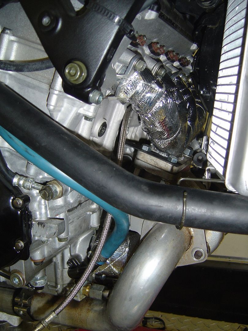

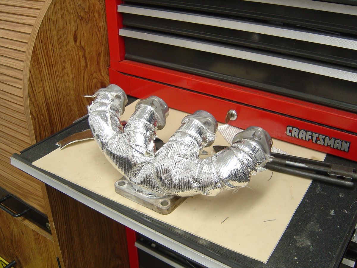

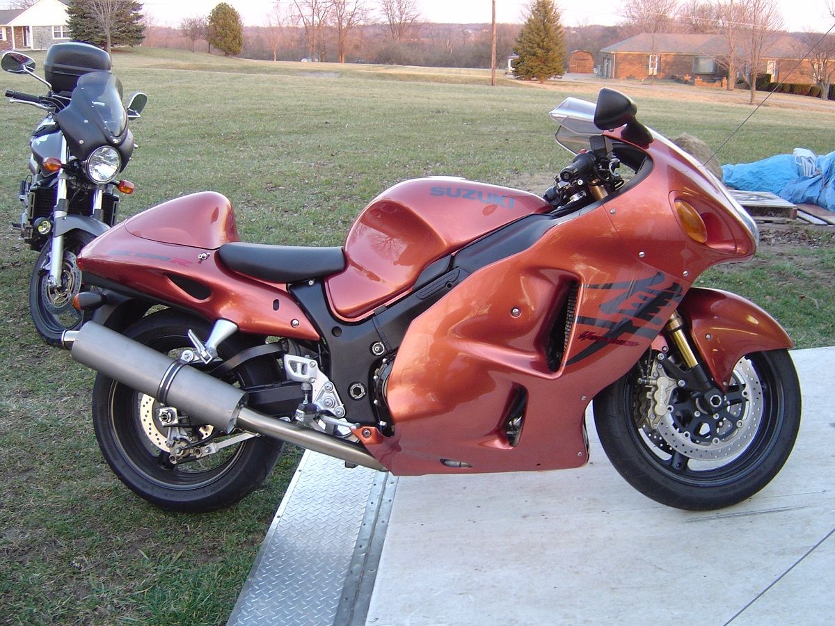

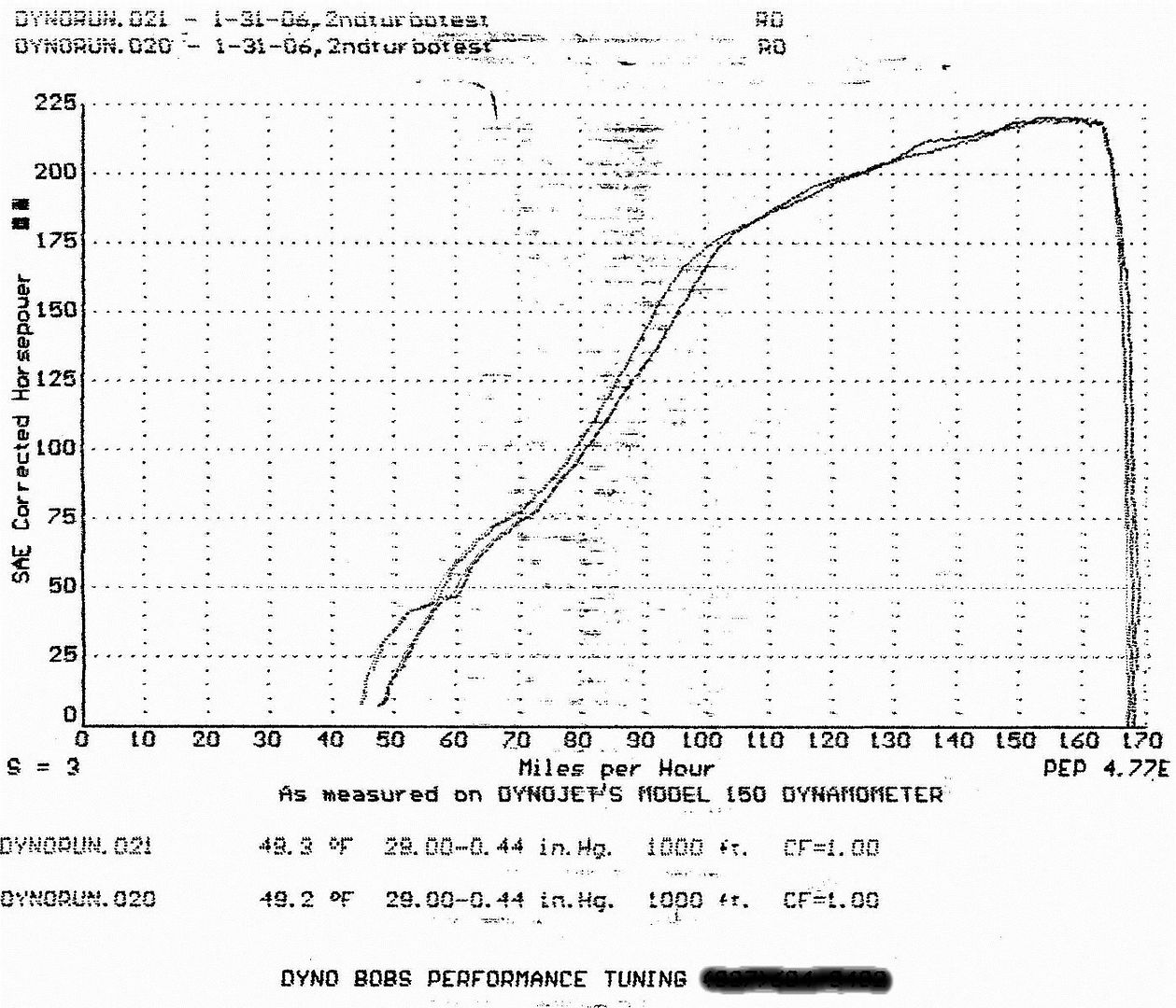

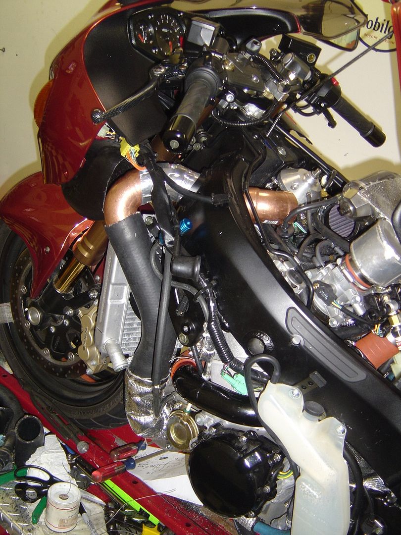

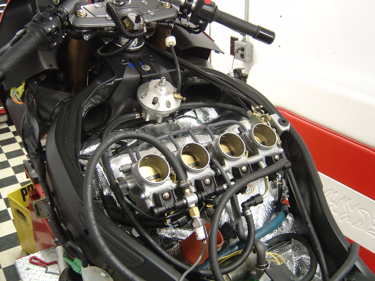

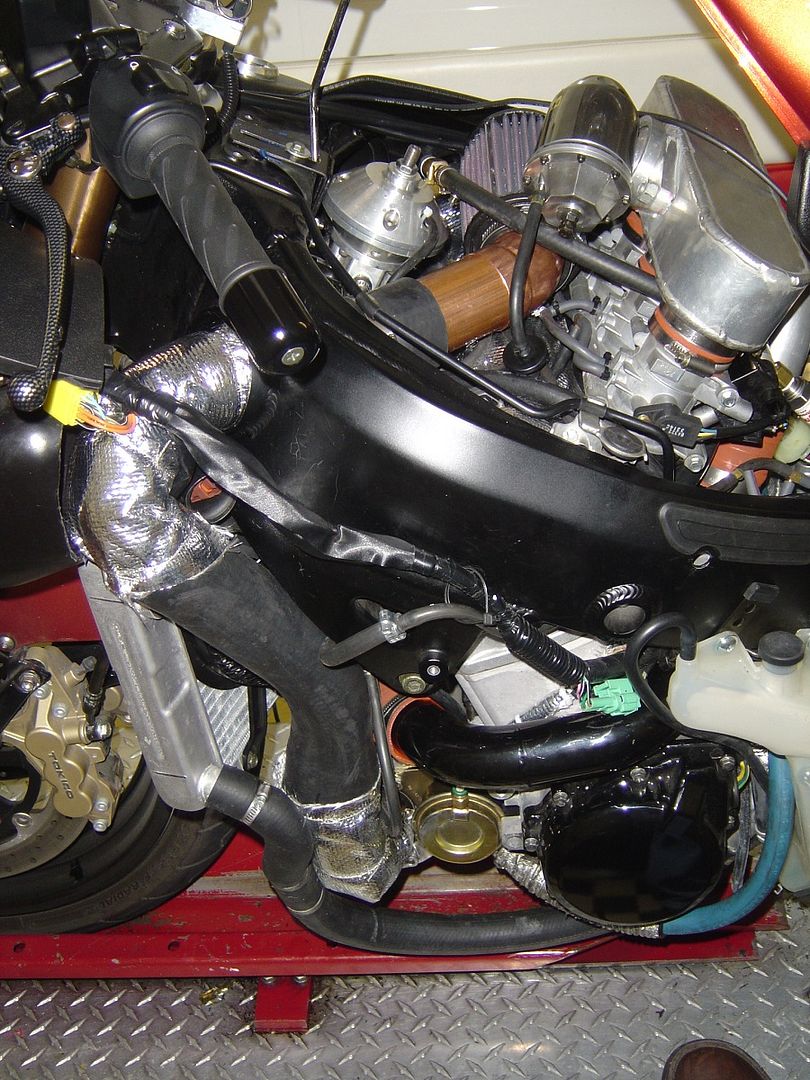

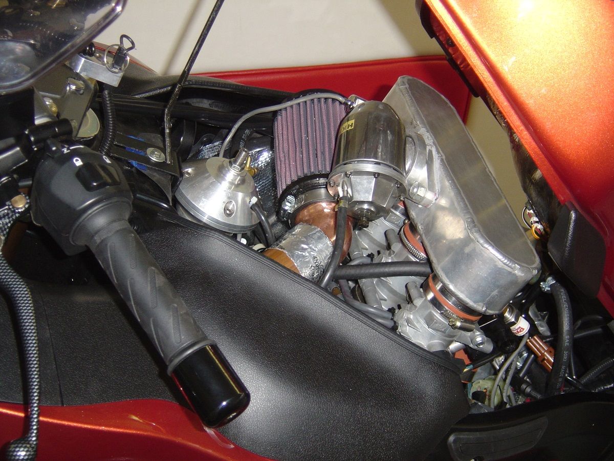

    This is a turbo bike I put together for a friend back in '06. A very mild, pump gas, stealth system that bumped the bike from ~170 to 220 rwhp.

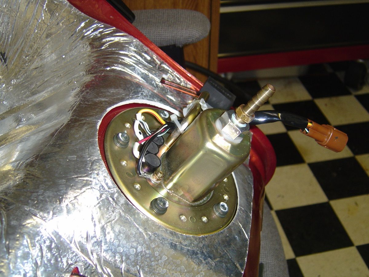

    had to add a return line bung on the tank
    boost indexing fuel pres regulator and lots of heat blanket
    hard piped the air filter to the top side to keep hidden and away from rain
    Finished product
    A word of advise (I think you already know this) ... Don't get impatient or shortcut the perfecting of fuel management - My buddy took the bike out for a ride while I was at work (before we'd done any vetting of the provided map on the dyno) and holed a piston - $2700 mistake as I recall...

    On busa, turbo bearing was above oil level so ok. We came off oil press sens port for oil feed to turbo w/ return bung welded in pan. On my 900rr the turbo is below oil level in pan so I have a shutoff on return line so oil doesn't seep. Don't forget to turn on or you'll smoke up the parking lot... :)
    Busa just used a custom map in Power Commander. Once correct it was fine.
