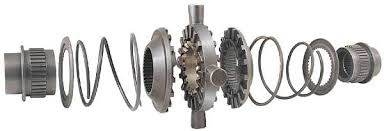

    A metal toothed 'Detroit locker' style spring loaded tooth set calibrated to release at a certain pressure would likely work, but it would take some machine work & a whole lot of developement for something that really isn't that dear or difficult to replace....
