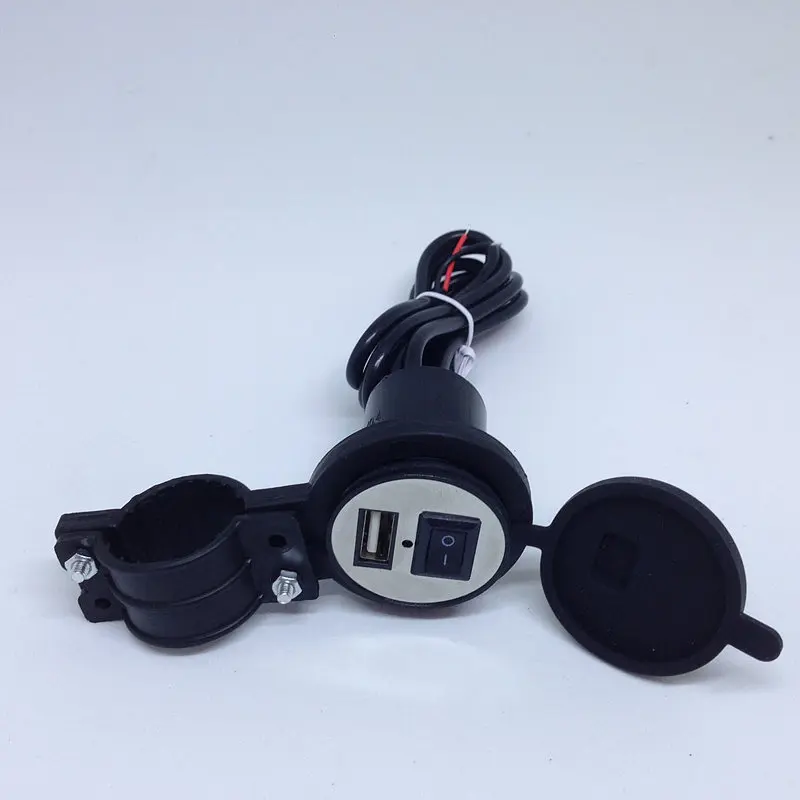

    I've install the SWM 650 Superdual windshield kit and it fits, looks and works great! You will need to purchase the plastic headlight mask of the SWM 650 Superdual as well because the Husky's one wont fit under the windshield. The frame that holds the windshield comes with a socket to install a USB adapter (see photo bellow) and this is great too!
    MonoShocker and KayDubbya like this.
