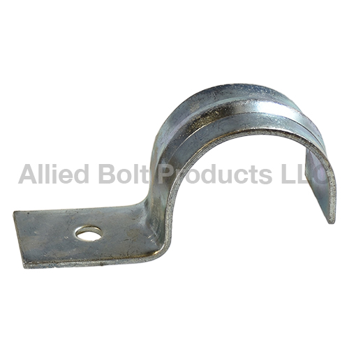

    they make solid plates. Never the most attractive things but hit a price range and are good. I have one on my 125 and 449. The front must be a bracket off the lower motor mount and the rear appears to be what I call "conduit clamps"
    these work OK but with time and after hitting the plate a few time rattle and don't hold all that well, I am always tighting the ones on my 125. Nothing wrong with them but nothing real quality about them ether and tend to get bent up. Good tough inexpensive plates.
