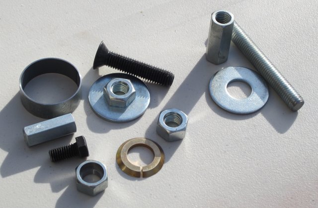

  7. Rapid Dog Husqvarna
    O.K., this is what I use. I happened to have one in my special tool drawer. It's a very clever tool designed for just that problem.
    Designed for use on BMWs but it worked fine for the Husky.
    The 'split ring' hard steel washer knocks down inside the race and retains it's shape once inside.
    Line it up evenly and center so it catches the lip of the race and turn it out with a wrench.
    Cycle Works - STEERING HEAD OUTER RACE BEARING PULLER- BMW's 1970 and LATER - $49.00
    I didn't take a pic of the race removal but this one is the same principle, once you get the kit it's common sense. You use the large collar shown above between the steering stock and the pu;lling nut/washer also above. The tapered bolt holds the split ring washer.
    I used the same set of nuts/washers and threaded stock and old bearing race to install the new races.

    Thanks mate! I've got one more trick up my sleeve, but then I'll be sending off for that puller. Looks perfect!

    ...Makes life alot easier ;)
