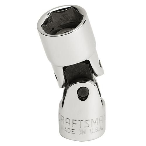

    I looked at the manual for the 499/511 they are using a socket and universial. Looks like it has the same or more clearance then the 310 does the Socket and ratching wrench I linked in the photo above will work well on both the 310 and 449/511.
    Also an 8MM swivel socket would be able to work on the 449/511 but not enough room on my 310 for a swivel to work.

    I finally had to tighten my 511 shifter.
    • Allen wrench barely worked, though I could have drilled another hole in the UpTite skid plate and made it work perfect.
    • Offset twist wrench worked pretty slick http://www.sears.com/craftsman-13pc...ckType=G30&PDP_REDIRECT=false&s_tnt=39869:4:0 (I got a set of these at Lowes on clearance for about $10...every once in a while they are the perfect solution. They also work great on the 8mm headed bodywork bolts)
    • Ratcheting wrench also worked fine.
