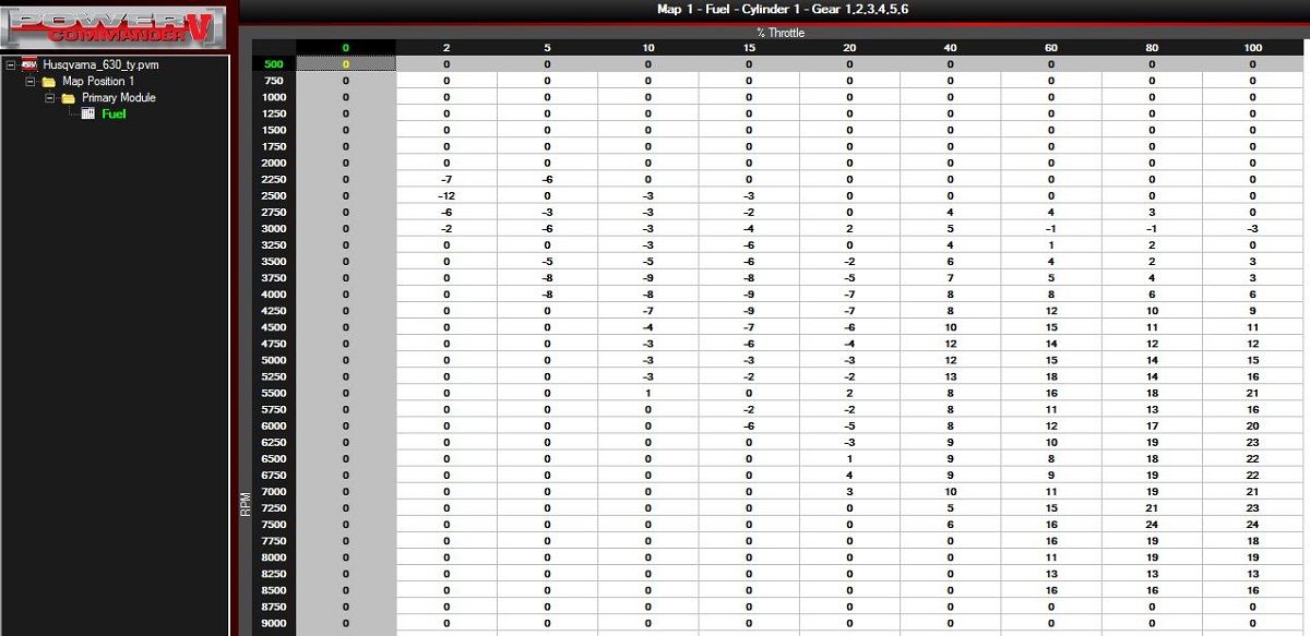

    Actually the Mikuni diagnostic software the dealers use is iBeat, we're all using the same software. The difference is, the factory cable is a serial interface instead of USB. You're right though Chris, the dealer may be unwilling to adjust the fueling, I'd say it depends on the dealer...
    Philthy, I'd recommend you go with 100/106/116. Looking at three different custom maps that Dynojet has built, our bikes don't need to add fuel down low. They just need a little added in the middle. Third number could be anywhere from 116-120, if you can get on a dyno, it will tell you the optimum number.

  11. DYNOBOB Husqvarna
    It's pretty similar to Dynojets results. Take a little fuel out or don't add much in low/mid, add a good bit on the big end.
