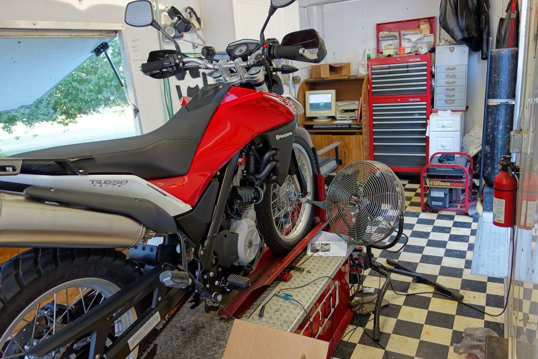

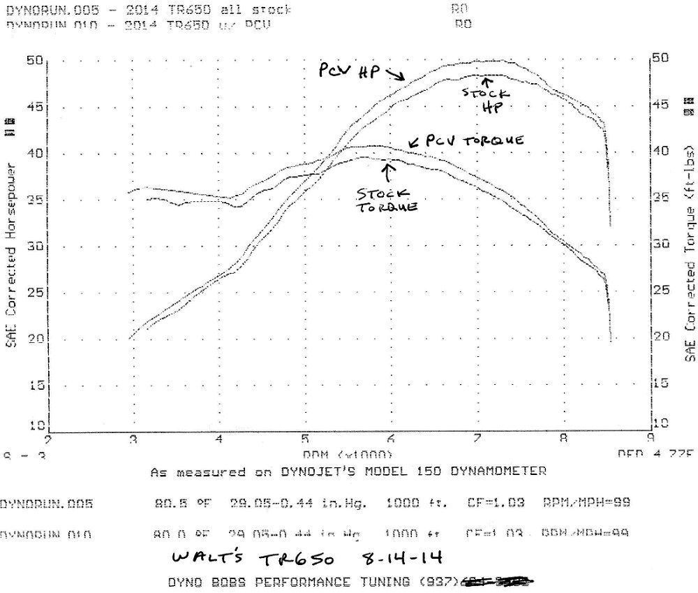

    I spent the day yesterday working on my buddy's 2014 TR650. Interestingly, the PCV for it unplugs the O2 with nothing plugged back in. It worked very well though.

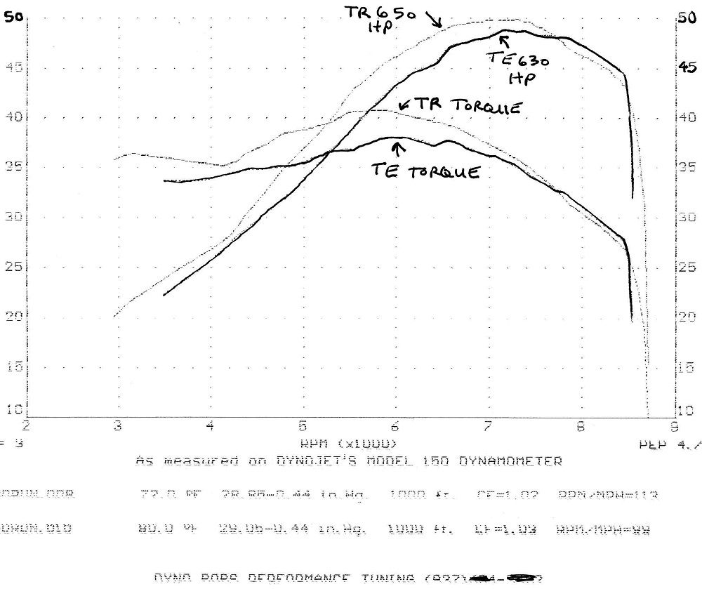

  11. DYNOBOB Husqvarna
    TR650 results with and with out PCV.
    TR650 vs. TE630
