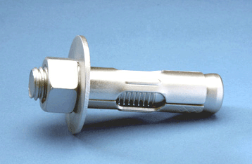

  6. DYNOBOB Husqvarna
    I've had success in similar situations with an appropriate sized concrete anchor.
    Xcuvator and Theo like this.

    I tried the heat and freeze method, not with the Loctite stuff tho. Might give the concrete anchor a try before dropping $80 on the tools.

    Tried the anchor, no go. 3/8ths is a little too loose to get a bite, and 1/2" won't fit. Going to give one more try with a 1/2" that I make fit. Bread didn't work. Actually tried playdough first, but it just extruded out of the bearing. Bread did the same, although with more resistance. Sigh.

    Damn it. Filed down a 1/2" anchor and got it seated well and it took a few good hard blows before the anchor popped out, bearing still stuck. Here's a photo of the playdough/ bread attempt.

    Got it hot. Hit it hard. No luck. Still slipped out. Off to Amazon to buy more tools. At least I get a new tool :-)
    I used a large crescent wrench under the washer, and blocked the case on the leg of the bench and my foot, and wailed on the wrench to try and pull the bearing out, but the anchor just didn't have enough bite on the id of the bearing.
