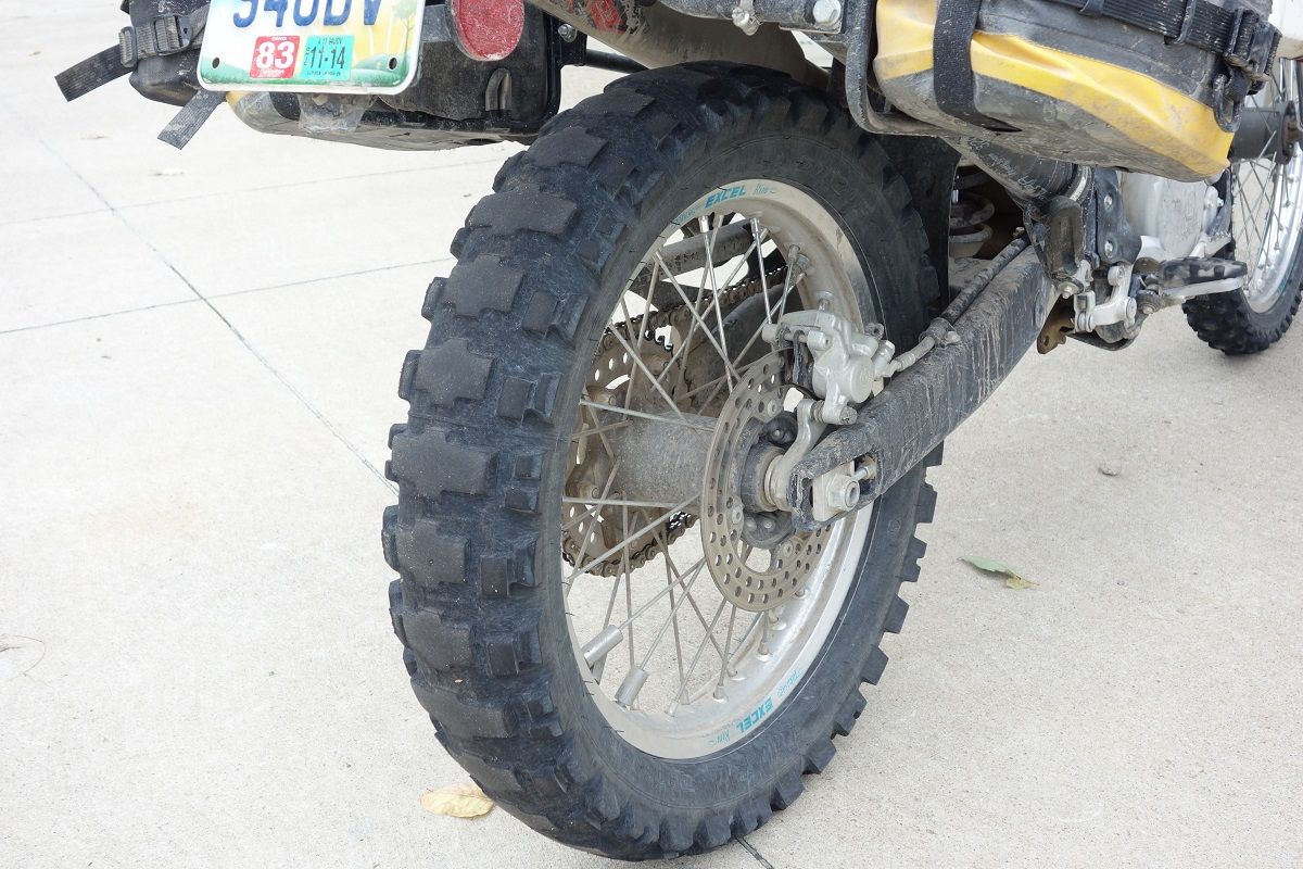

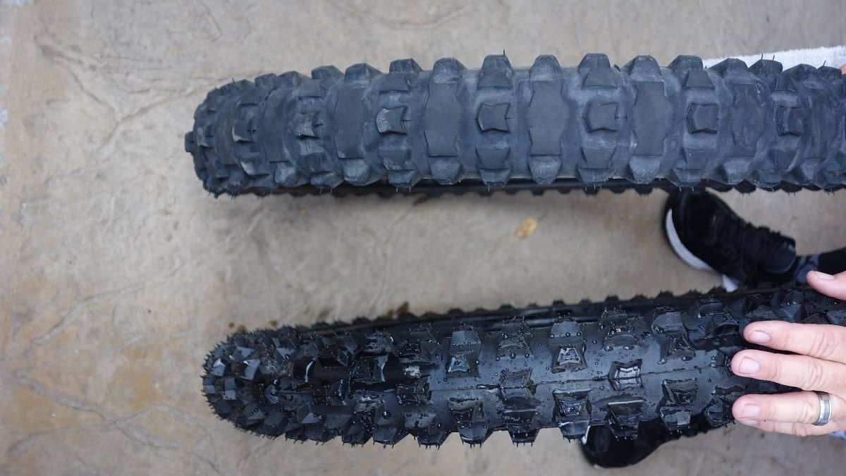

    IMO, it has great grip driving you forward in sand or mud but it's lateral grip on loose surfaces is pretty bad. Looking at the tread it makes sense. The wide continuous blocks have no voids (like your AC10 does) to keep it from sliding side to side. Not too much of an issue for my sight-seeing riding style, it's more important to me that it keeps things moving forward (I'm not out railing thru corners on loose stuff). I can see why the fast guys here don't like them though. I will say that what hurts the tire laterally on loose stuff probably helps it corner on pavement, those blocks for sure aren't squirming.

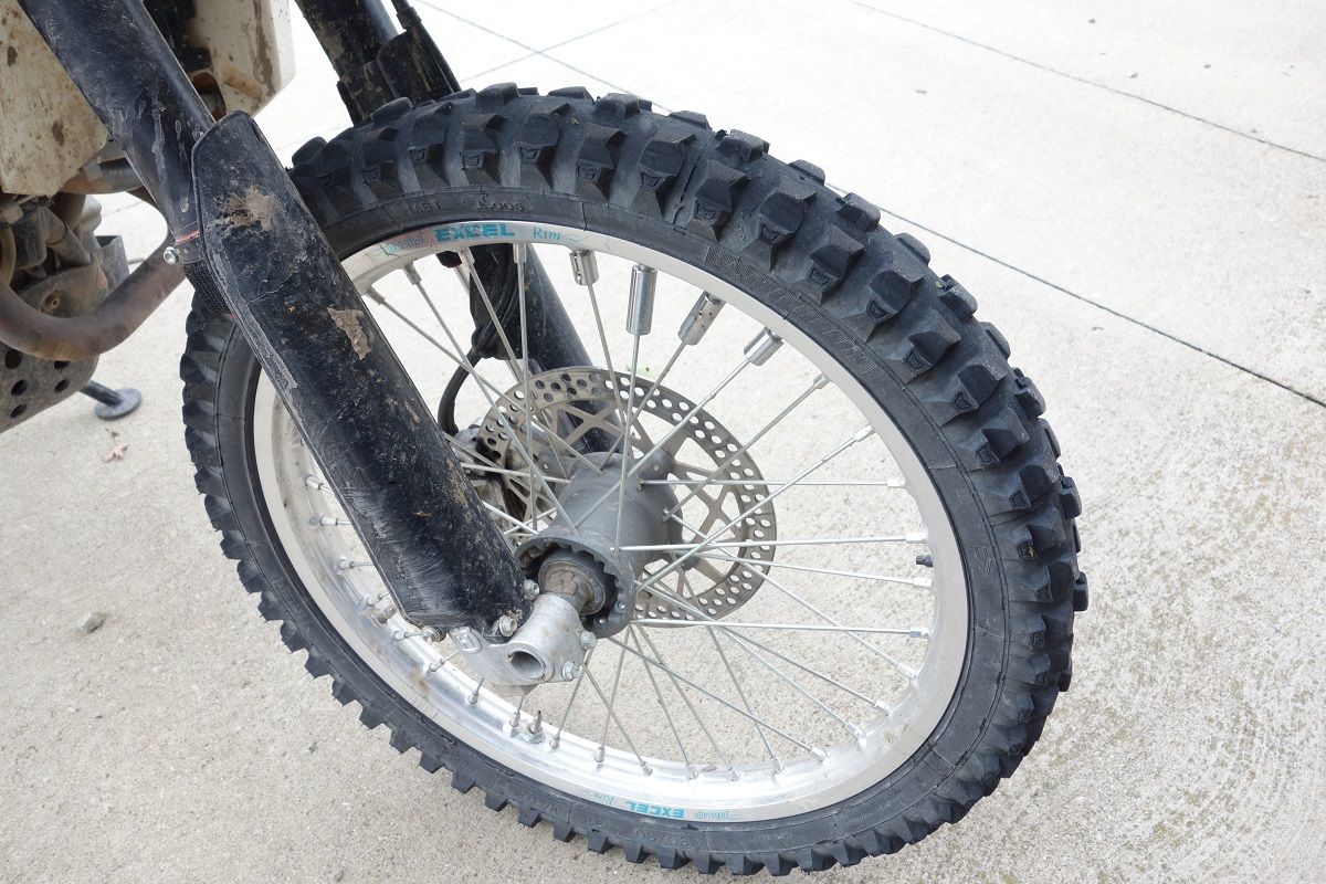

    D606...love it. It's a much better tire overall than the T63. The dunlop is actually much quieter on road than the michelin. Go figure. It holds up better and has deeper lugs, wider tread.
    Out front on the last trip I had a Karoo II lying around so threw that on in place of the Michelin Desert because there was gonna be a lot of hiway - worked really well for that. Scalloping badly though. Ran it on my Tiger as well, good there too. Desert was best for sand of anything I've tried. Melts on road, also pointy little knobs not so grippy on sweepers. A fellow rider washed out the front on road and went down - pretty scraped up.
    Going back to Scorpion Rally for the front though. Will keep the D606 rear. The rally is just the best tire ever.

    I agree on the Rally! I have a new Mich. Desert front to try now. Having the most problem with the rear, cant seem to find the perfect dot rear..

    Just finished 2600 mi "ForeverWest" trip on my Dunlop 908 rear and Mich Desert Race front...
    The 908 has 5939 miles now. It has been just the tire I hoped it would with no punctures, long life, and good traction even now. IMO, the key to liking this tire on our bikes is never running more than 15psi. I run 6-8 psi and don't air up to 15 unless I have a bunch of slab. I do run Tubliss so no fear of pinch flats but as stiff as it is (a 5 ply tire) don't think you'd have much to worry about with a tube. Some say they're hard to mount but I've put two on 630s and they were easy.
    Desert Race has 4048 miles and again I couldn't be more pleased. To me that's amazing for a true knobby tire. The center knobs must be made from stronger stuff than the side knobs because they're still standing tall. I've kept it at ~18psi (again w/ Tubliss).
