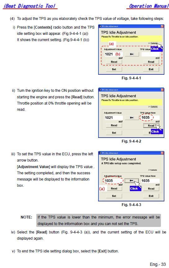

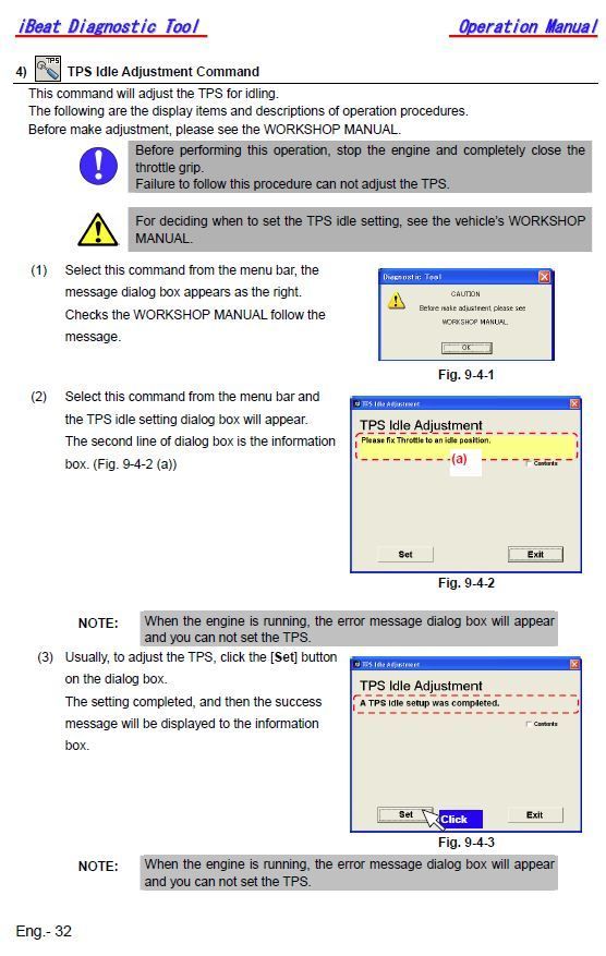

    My interpretation of the instructions is:
    1. Set idle to where you want it
    2. Follow instructions below to make the Adjustment Value match the TPS value.
    You are not adjusting for any certain value, you just want the ecu value to match the physical value.

    My reading of the instructions would say you need to set the "Adjustment Value" to 957.

    I want to make sure I have not said something that has misinformed you. You need to set your "Adjustment Value" to match the actual "TPS Value". These numbers do not affect the mixture leanness/richness in any way! All you are doing is making the ECU map more accurately track the actual physical opening of the throttle body. You MUST address the fuel mixture in a different way. It appears that the 610 bikes ecu doesn't allow adjustment with iBeat for some reason (if you are a 610 owner and have been able to change the CO settings please speak up...). A JD tuner or Power Commander may be the only way to adjust mixture on a 610.

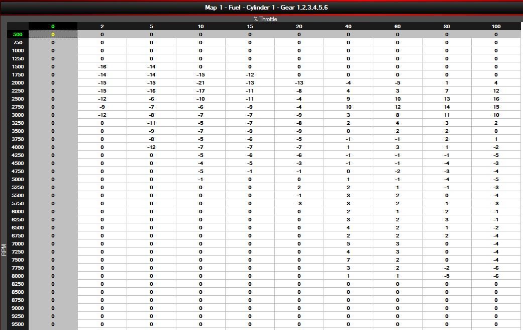

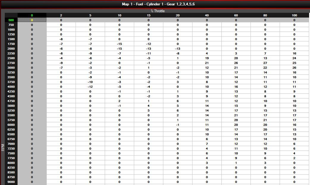

    These are two Power Commander maps for the 610 from Dynojets website.
    The map for a stock bike says they are very rich down low and not lean on the big end.
    The LeoVince slipon/modded airbox map says the bike is rich down low and quite lean on the big end.
    Good luck!

    The TPS voltage value at idle is ~1volt, at full throttle it is ~5volts. The ecu is basically translating that voltage value to a percentage of full throttle and applying the injector pulse width that the map calls for - which hopefully provides the correct fuel. Aftermarket tuners are taking the factory injector pulse width and adding to or taking away a percentage, that is the only way you are going to richen/lean a 610.
