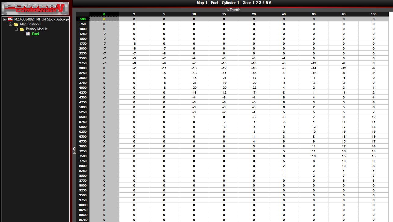

  20. DYNOBOB Husqvarna
    Stock Map
    FMF Q4/Stock airbox
    Full Leo/no baffle/610 airbox(?)
