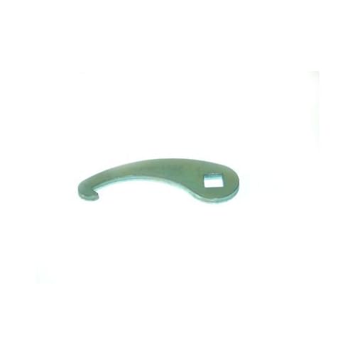

  9. RidingDonkeys Husqvarna
    Paso Robles, CA
    TR650
    If you want a field expedient method, try one of these. It is a $10 shock adjustment spanner. Cheap, but effective. You can use it on almost any shock, and it turns with a 3/8" drive ratchet, which you probably already have in your toolkit, so it packs light too.

    BTW, shock adjustment spanner wrench. When searching, the diameter helps get one that fits best. They handed me a minimal tool kit when I bought my bike, and it has the spanner. I'm on 2nd softest setting.
