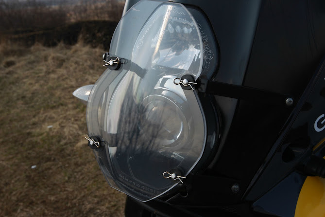

    Regarding your set - a couple of curious questions:
    - is the stone guard not interfering with windshield as to remove the front guard panel easily as planned by TT ?
    - is it possinle in your opinion to swap the mesh guard panel with some clear macrolon one using same TT mount ?
    I'm planning something similar like that (using exactly the same mounting technique with pins):
    HuskyDude likes this.
