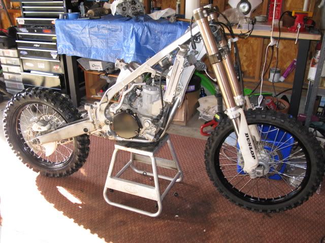

Hello! I want to put black wheels on my 07 TE 250. I want it to look like the 08's and newer ;). When I googled for information, well, nothing came up. "Excel", which is the brand thats on it now, doesnt seem to offer them? Do I need to just order 08 Husqvarna wheels from Tasky's?
Are they the same (07 to 08), just different colors?
And also, how much to install them? My Boyfriend says he wont do it as it is apparently a pain in the butt?? :excuseme:
Thank you to anyone that response!

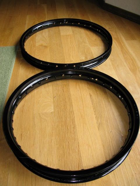

Hooray!! I love Cafe Husky**************************************** I did a search on here, and found a thread that was about Hall's Cycle's (somewhere back east) having special rims made. Black, special rims!!!
So, I told the BF and he ordered the LAST pair they had! Only $100 per rim too! But now he has to take the wheels apart and put them back together.Oh well . . . I will have to do something a little extra tonight :D:D:D:devil:
