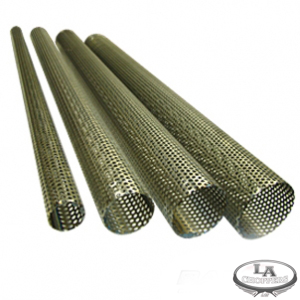

Make sure they use some nice quality perforated tubing or it can sound terrible.
Good:
Bad:
Good:
Bad:
