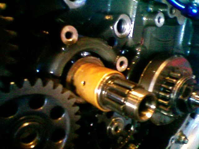

So I bought a slipper clutch for my '06 TC250 from GP cycles. Well it doesnt fit on my bike, even though it came off a 250 of the same generation. I think it came of a TE model.
So I was wondering if some of you guys with a 2005-2007 TC AND TE model 250 could get some measurements of the layshaft for me. The shaft where the clutch slides onto. (If your bike is apart at the moment, and if you would be so kind...) Im looking for the distance from the end of the shaft to the shoulder of where the bronze sleeve sits. Mine measures approximately 27mm. Im wondering if other year TC's or TE measure differently.
Im also looking for a measurement on the clutch basket of said bikes. I need to know the distance from the back side of the gear on the basket to the inside of the basket. Thats also where the bronze ends. So maybe grab the length of the bronze sleeve?
