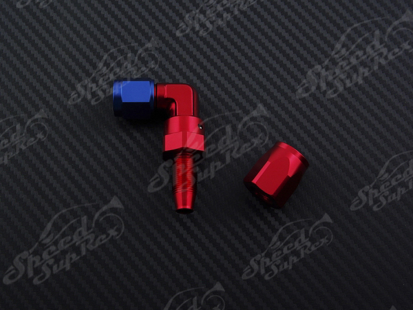

That sounds like too much PT. I'd rather find a steel step down connector for the oil drain plug to replace the aluminium one supplied in the zip-ty kit. The aluminium connector seems far too flimsy and vulnerable to permanent damage.
You could try a forged 90 AN, XRP makes the best. I suggested this, but the cost was too high for Ty to go with it.
900506 combined with a 230006
