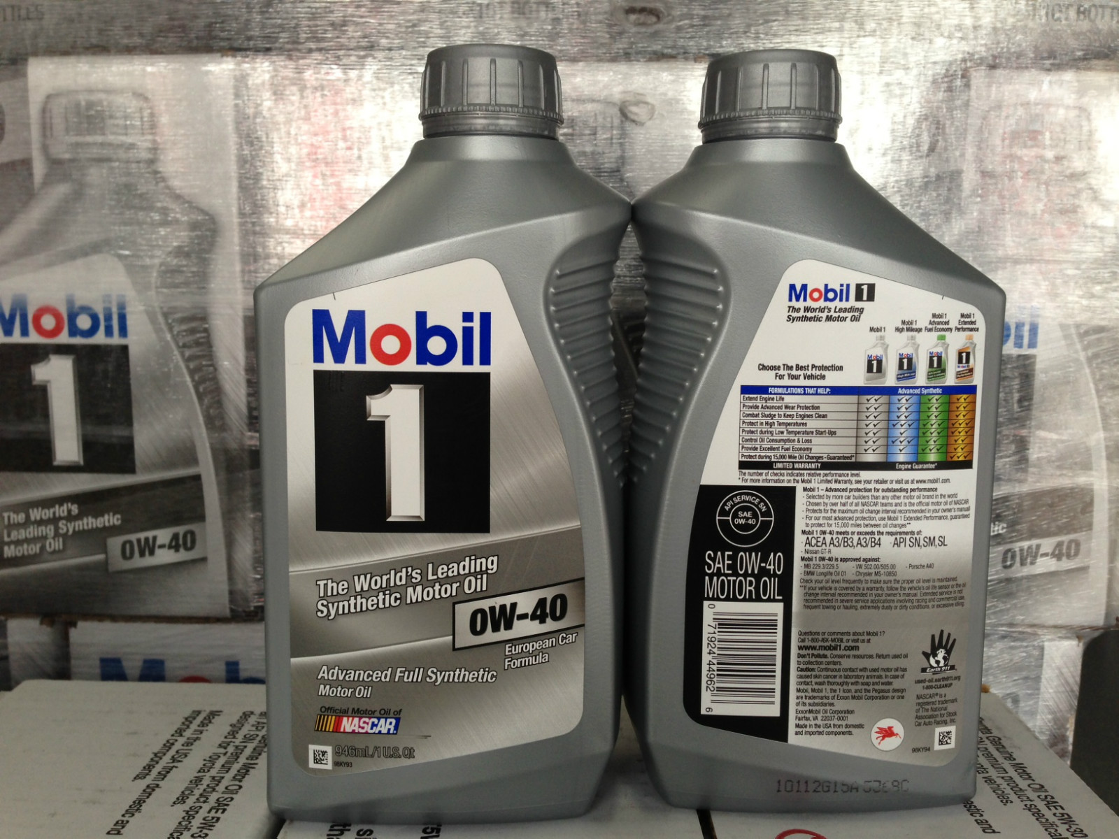

Where to get Mobile 1 0w-40?
So this oil would work in BOTH chambers on my son's Honda 450x? It has separate engine and gearbox.
Sure, this grade would work well for you. You should also consider using 0W30 in the Honda 450x as long as it was not the green capped energy conserving bottle.

Walmart price variation on Mobil 1 0w-40 European formula.
Tinken reports lower Walmart prices than here in Washington. Curious, so I went to our other local, east valley, store today. It has the 5 qt. jug at $24.97, compared to Tinken's price at 22.47. Which makes me wonder what sort of algorithms govern price setting for national chains. Especially since our area ranks lower economically than his.

I saw it yesterday in a PartSource store, you have a location in Kingston.
Popped into a Parts Source and VOILA..FOUND. Changed oil and am wondering if this is as magical as it appears to be?!?!?!?! First off...It's minus 5 C and minus 15 C with WINDCHILL..decided to ride up to a nearby powerwash centre and cleaned err up real nice before swapping out the Motul 10W40 to the Euro spec 0W40. Here's where the apparent magic happened...I have a z-Start pro Rekluse..i started up the gal and just popped out of the garage and did a couple laps up and down the road. Is is my imagination or MAN..the REKLUSE engages instantly with throttle response AND I can engage into neutral WITH the engine running...I am SOLD on this oil**************************************** The cost was 11 bucks a litre as opposed to the 15 bucks for the Motul and this is now a full Synthetic!! The Synthetic Motul is going for 17 bucks a litre so a wopping savings of 12 bucks an oil change :) Interested to know if other Rekluse riders have noticed this immediate difference??

Great news! I have been sold on the Mobile 1 for a while now and I am adding a Rekluse after Santa stops by next month and I was hoping it would work good for the auto clutch.
I tried the Mobil 1 0W-40 and the bike ran good but the shifting wasn't as smooth (for me) as when I use Motul 10W-40 synthetic.
