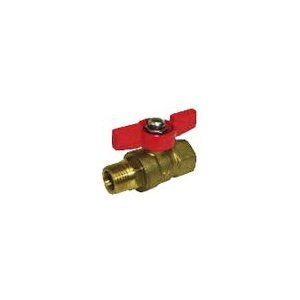

...be used to replace the oil tank drain coupler that dumps oil all over the bike? What size do you think those oil lines on our bikes are, about 1/4" or so?
	I found a 1/8 NPT mini valve on Amazon for $8. I ordered it and it should be here later this week. If all goes well, I'll be installing it next weekend.

Pretty good chance the thread in the tee-fitting will be metric. If it has a copper washer to seal the existing plug, it will be a fine pitch, parallel thread.I found a 1/8 NPT mini valve on Amazon for $8.
Are you going to leave it in that position or are you planning on loosening the hose clamps and spinning it so it points downward (handle to the rear)?
Heck...even if yoy lost your church key, you could just use something like a 1/4" open ended wrench to turn the valve.

Now that you mention it, yes, I'm probably going to rotate it so the valve points down. Hopefully I have time tomorrow to get at it.
