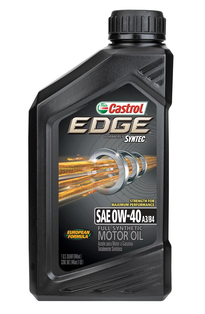

motul 7100 is $90 for 5Litres, bloody expensive.
i am also worried as its 10/60 and what the bike specs ?
we ride from about 5 deg on really cold days here to 40 degrees peak summer.
ive just bought a gallon of this but will drain it and not use it if its going to be a drama ??
what about these ?
