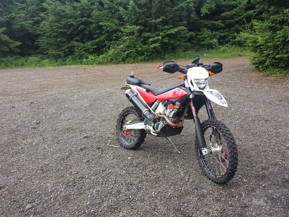

Rode my 511 today after a long stint on my 250. Man I love that 511. The ZipTy suspension is incredible. Yes the bike is kind of big and nasty but I had so much fun chasing my 2013 KTM 300 6 days freind down on his wonder machine through the woods. Even in fully loaded DS mode shes a ripper.
Perfect conditions today...
