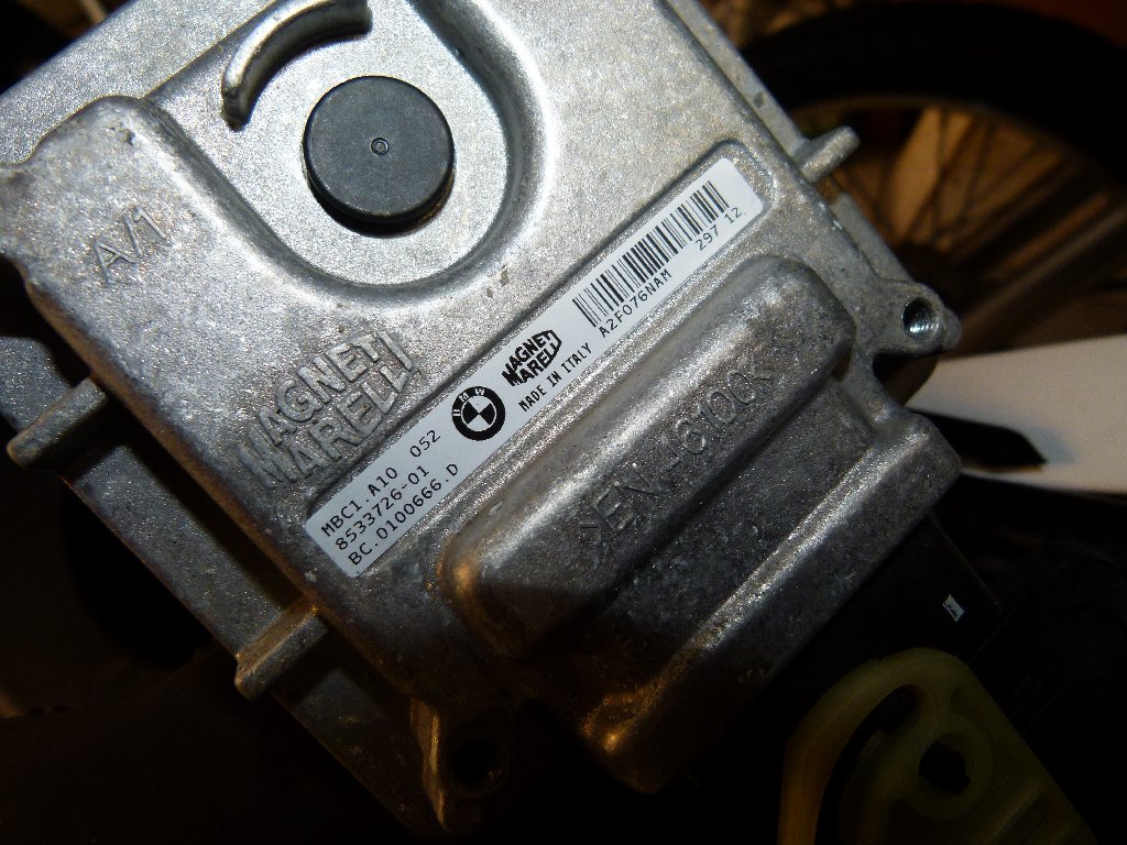

Everyone who has lodged a DOTARS report, I am trying to look into something re the BMS-E ECU, on the under side of the ECU under the seat there is a label with Magneti Marelli and BMW part numbers, I want to see what numbers are on each machine, can you all get me pic's or numbers ?
Hi Wayne as requested:
Thanks Geezer, it is the same revision as Stuart and Sussurf, so far it is only the Nuda ECU I have on the test bench which is the earlier version
Thanks Snow Dog, pleased to see some dirt on that ECU, been out using it for the purpose it was intended I see :)

Mine is a US (type) bike, in Philippines with
MBC1 . A10 052
8533726 - 01
BC . 0100666 . D
Same as them all :-(
Thanks Mark, it seems clear the Terra/Strada's are all first hardware revision (BC . 0100666 . D) so we can probably rule out problems due having original version
