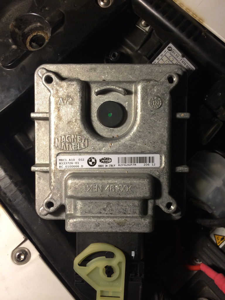

ok can we start with gathering some data on the ECU system:
Who manufactures the ECU, is it www.magnetimarelli.com?
IAW MBC
The “stand-alone” control unit, designed to support the “traditional” architecture, is made using high-density SMD technology. It weights approximately 300 grams, and it can withstand operating temperatures from–40°C to +65°C for full-load operations and up to +85°C for minimum operation. It is intended for installation to the vehicle body.
The connections to the external input/output are carried out by means of a single connector with 48 ways.
The control unit pilots up to 2 injection channels and 2 independent ignition channels, a stepper motor for minimum control and a driver for the piloting of the canister valve. For those versions that require it, the exhaust valve position control and the traction control management is integrated in the system at the logic level. Mixing is controlled by means of 1 lambda probe of the heated ON/OFF type.
The reduced overall dimensions make it easier to be installed on the vehicle.
Do you own this system? Any information on what is needed to install it on our bikes?

I just sent them an inquiry along with a picture of our ECU with the Model number. I will post up if and when I hear back from them.

Guys this is all good stuff......but magnetimarelli.com is a huge company (as I understand), we just need someone who can speak Italian to go to their customer service people and explain our situation and inquire of the options that are available to us...I will spend money too.....I am not asking for anything free.
I got a follow up email from Technoresearch. No help!
Hi Charles,
Unfortunately we don’t sell any tools that can tune/remap any Husqvarna. We do have a diagnostic tool, but it is limited to diagnostic features only.

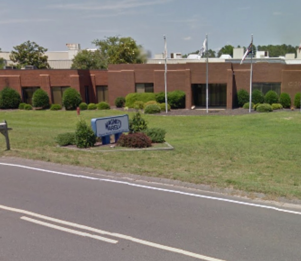

Who lives near here in North Carolina?
SANFORD - MAGNETI MARELLI POWERTRAIN USA, LLC
Powertrain
2101 Nash Street, Sanford P.O. Box 548
Sanford
Tel +1 - 919/7764111
Fax +1 - 919/7756337
